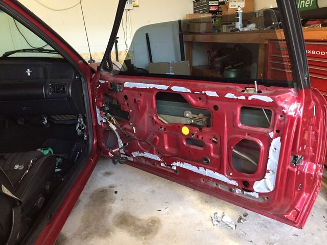

    Well my sit back and just drive the car didn't last long lol. After painting the front and rear window moldings I decided to finish it off and paint the trim around the doors and start installing all the new parts that I've had for over a year for the doors.
    Installed new window weather strip, run channel moldings, speakers, window motor, power lock motors and putting in the FatMat sound deadening material on the doors while everything is off.
    1993 Coupe

    the window guide bushings proved to be the biggest PITA trying to get the guide rod in and out of the door without scratching the window tint.
    1993 Coupe
